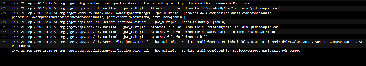

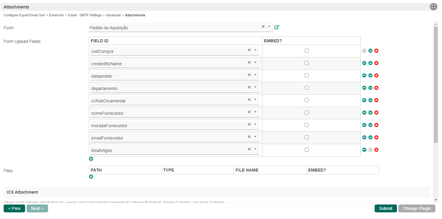

For the logs you're showing: Form Upload Fields is used to identify field elements like file upload or image upload in the form and attach it separately into the email. So fields like "createdByName" and "dateCreated" are not upload fields and you'll get the error "attached file fail from field". Ensure the you review that the fields you added in Form Upload Fields are upload elements i.e file upload/image upload.

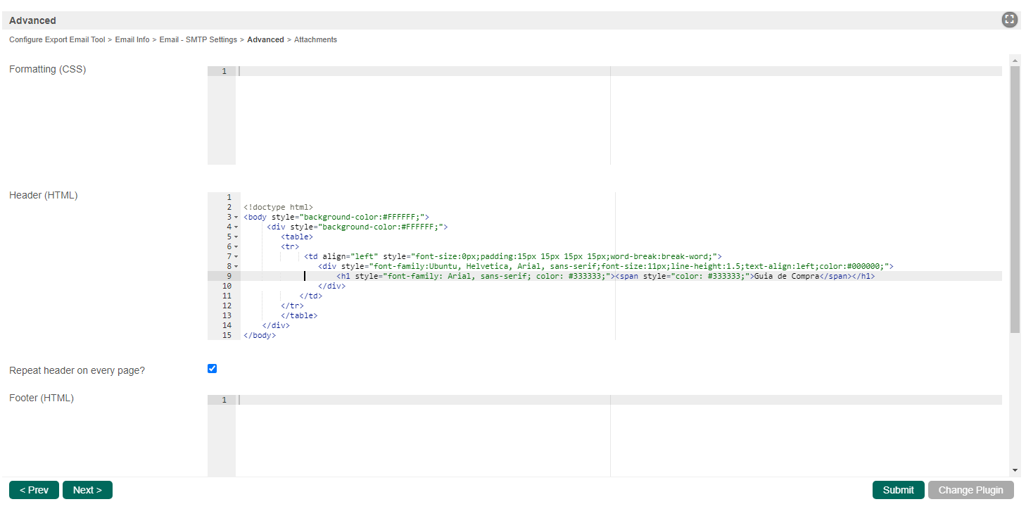

Another thing that was blocking the generation of the pdf was the error in my html code (on the header).
I run it on https://validator.w3.org/#validate_by_input (find this on another thread) to see if the code is correct.

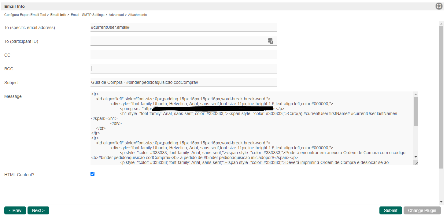

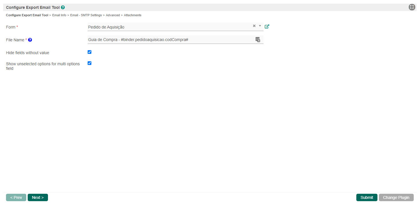

I already add the plugin Export Form Email Tool, but i don't know why, don't send the attachement.

Here are the step's of the plugin configuration
In the Logs give me this error:
