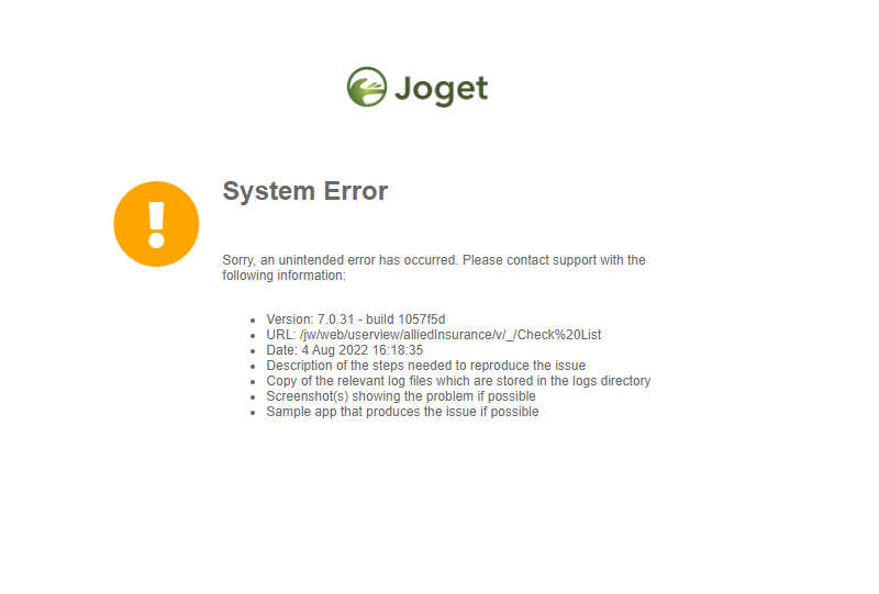

You can download and attach this File Link Datalist Formatter Plugin to your datalist column file upload field, to see the attachment: https://marketplace.joget.org/jw/web/userview/mp/mpp/_/vad?id=file_link_datalist_v1
Hey Matthew King Thanks . Is it possible to Download the file from Datalist only? Is there any steps?
Try the attached app below giving example on the use of the File Link Datalist Formatter Plugin in Datalist Builder-Column-Formatter:
Got it Thanks. I forget to make changes in Action Mapping.
Hello All,
Is there any way we can View/Download the Image,PDF,DOC etc which has been saved in Forms.
I am looking through Datalist and getting the below error.
Regards,
Akhil
