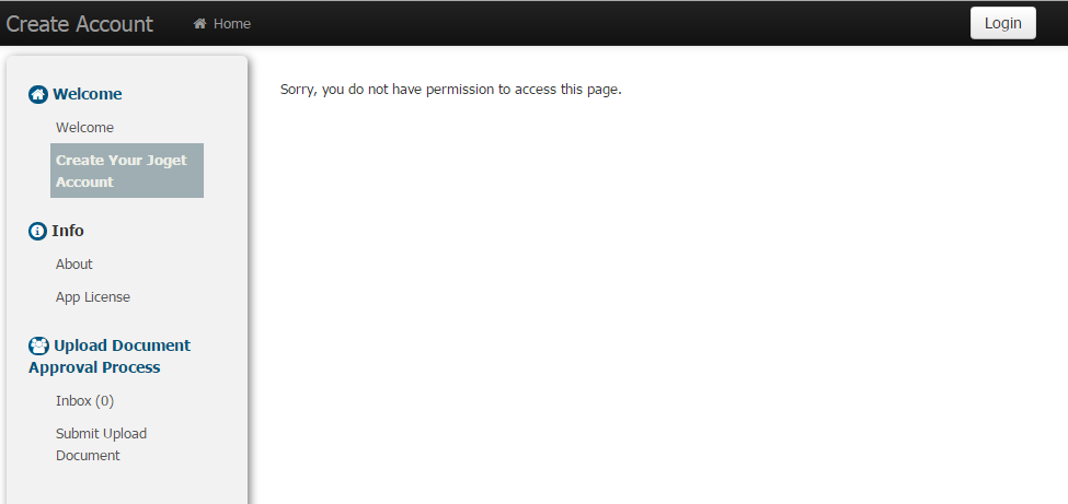

When you import an app into Joget, it will be default set the workflow permission to admin only.
Do remove the permission in "Web Console>Processes>Map Participants to Users>Process Start White List". Click on the "Remove Mapping" button to set the permission to 'Everyone (Including Anonymous)' for the Account Creation new process and your 'public' users will be able to signup using the account creaiton form.
Hi, Matthew King Thanks this helped to fix the problem.

Hi, I'm trying to allow other users to create a Joget account themselves rather than it being done just by the Admin. P.S. I am using the create account app found on the marketplace
How ever I get this
After checking the permissions on my forms, all of them are empty and any user should be able to view the page. Am I missing a permission restriction somewhere for the create account page?
