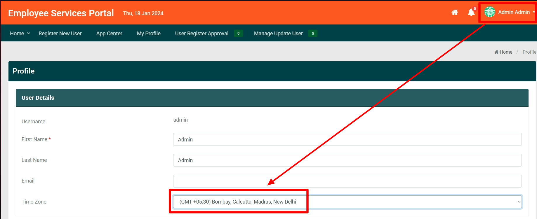

There are two convenient methods to configure settings, with the first option having the highest priority and involving access to the application profile, as illustrated in the figure below:
First Option :
User Profile Settings

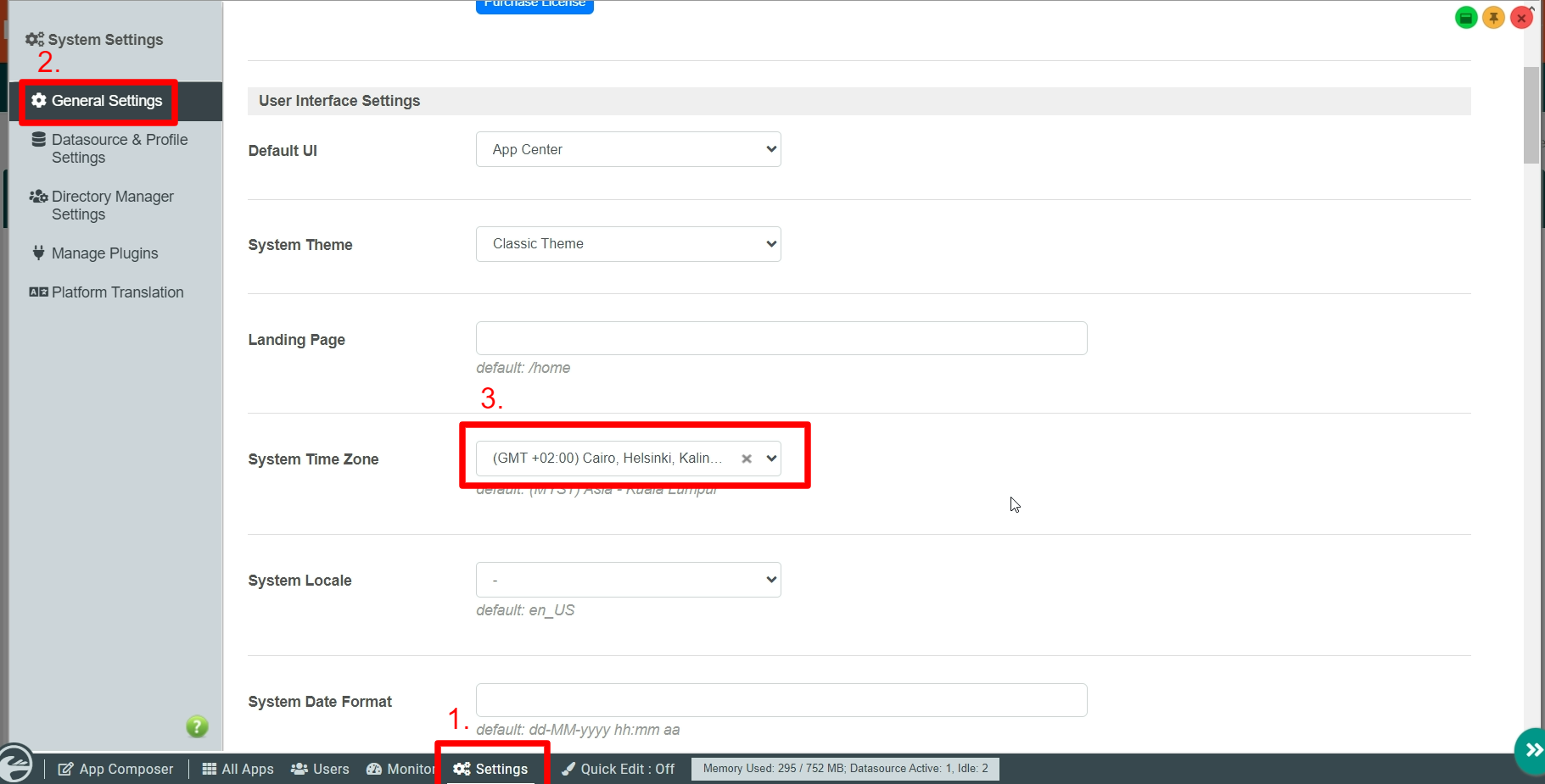

Or System settings> General Settings : General Settings#:~:text=Figure%203%3A%C2%A0%20User%20Interface%20Setting
When you configure your timezone settings in the app, all timestamps throughout the application will automatically update based on your chosen timezone.
Take note the first option will supersede the System setting’s timezone configuration. > Maybe you can check whether the setting in the User Profile is different than the one from the System Settings.

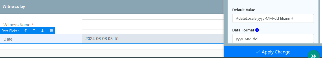

Hi, why my date locale does not match my time here?
![](/community/download/attachments/287211741/image-2024-6-6_11-19-28.png?version=1&modificationDate=1717644047000&api=v2)
