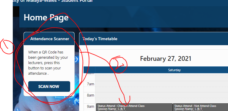

But if wanna record attendance ( using QR code ) and save in the calendar for future documented ( by printing ), is it possible ?
1) QR Code appear , The user scan the QR Code and type in ( his name , time <auto recorded> and company)
2) Automatically registered in the system display it. Will listed the names in a menu .

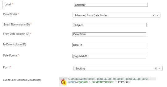

Entries not appearing won't be caused by the "event click" code.
You will need to check your data binder.

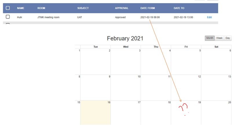

I watching the youtube video "How to Build a Meeting Room Booking App". But I got stucked at the calendar part.
I approved it , but it does not appear at the calendar
These is my configuration
Is my javascript is correct ?
