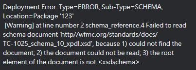

It is what the log says: failed to read the http://wfmc.org/standards/docs/TC-1025_schema_10_xpdl.xsd document. The website (wfmc.org) is down. The xsd is in the twexpdl-2.0.1.jar, you can find it in apache-tomcat-8.5.41\webapps\jw\WEB-INF\lib\twexpdl-2.0.1.jar.
I extracted that xsd, started a simple web-server on the joget server then I put this xsd in the folder standards/docs under webroot, then a modified the /etc/hosts, to send the wfmc.org web-calls to the localhost.
It's ugly, but works.

Community v7.0.15 Windows version & docker version also got same problem too.
Is there anyone can help?
windows version got same problem too.
openjdk version "11.0.10" 2021-01-19
OpenJDK Runtime Environment (build 11.0.10+9-Ubuntu-0ubuntu1.20.10)
OpenJDK 64-Bit Server VM (build 11.0.10+9-Ubuntu-0ubuntu1.20.10, mixed mode, sharing)
OS : PVE + CT (ubuntu 20)
I used Joget v7.0.12 community for couple weeks, it works will.
But recently, I want to change the process, when I deploy there is a xsd file missing error, so it doesn't work.
I download v7.0.15 to test, same problem.
Only profession and enterpise version can avoid that.
Is there anyone can help me to fix the xsd file missing problem?
