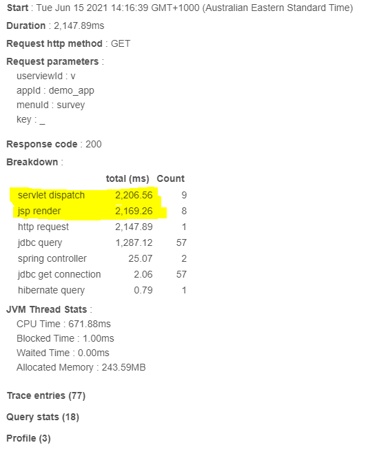

Hi, if you have a very large form that loads in a single request then it might require a lot of processing. Based on the screenshot, the JDBC queries alone also take more than a second. If the form is too heavy, you might want to consider breaking it into smaller pages using a Multi Paged Form, or utilize caching like in Performance Improvement with Userview Caching.

I monitor the performance and got the following report:
Why jsp render and servlet dispatch taking that much time? How to fix it?
