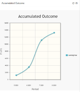

Issue resolved
the log said that it was an issue with the SQL code.
I was able to rewrite my SQL code, in a way that Joget was able to handle:

and the chart looks like this
