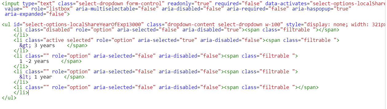

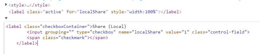

When I unchecked share (Local) checkbox, I want to set blank the select box as empty. I have try it but did not works in set value as blank, .selectedIndex = -1 and also set aria-selected to false. Need you guys help. Select box and checkbox code as following:
