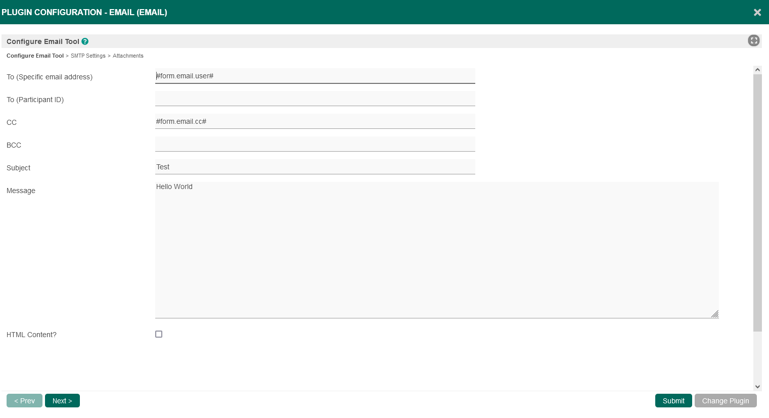

In my opinion, you should use the form hash variable in the email tool.
E.g. use #form.yourtablename.prt_fm_SubmitWk_PTMonitor# for the To(Specific email address) and vice versa for the CC.
With this, you will not need to configure any workflow variable and you only need to make sure that the users have already set their emails in their profile.

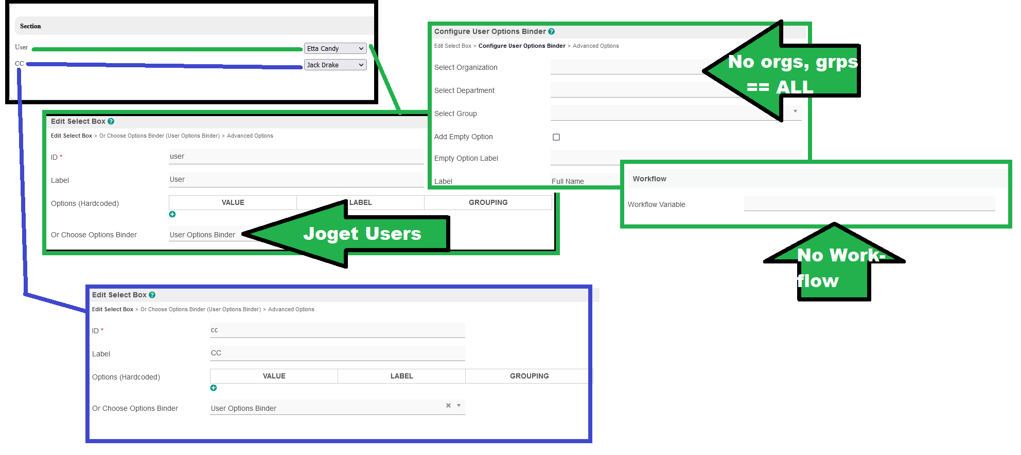

So on the design: (0) there's NO source/SQL like I had in my #1 above, (1) the Joget users are still all pulled [GREAT to me!], (2) there's no orgs/groups [so this will list ALL the users – which can be easily configured], and (3) there's NO workflow variable (to Reid's point – which is ALSO great!)

Edit: For posterity here's Reid's Email Configuration:

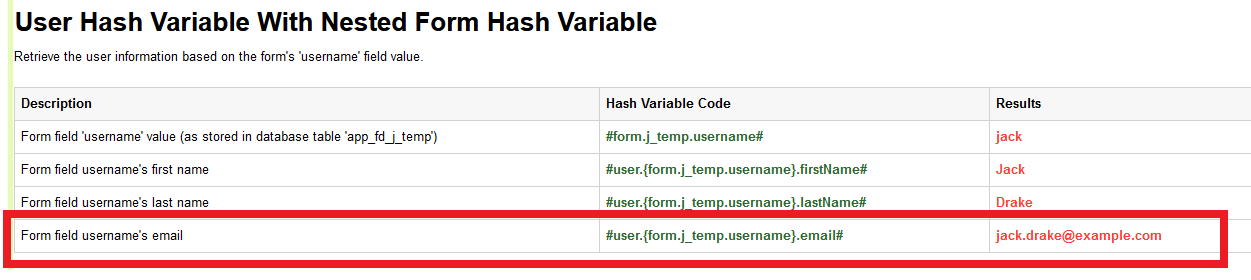

As an update – Reid's method did WORK! I also leveraged it to use the "nested" variables.
For instance if you know the "form variable" that hosts the User name (e.g., form.<FORM NAME>.<FORM OPTION ID>.username), then you can use that in a nested username (e.g., user.<USERNAME>.__Option__).
Thus, I had things like: #user.{form.yourtablename.prt_fm_SubmitWk_PTMonitor.username}.fullName#, because the Datalist would store the username ... which I could use for subsequent emails/Userviews/etc. (for example I stole the name, used a Form Update Plugin, with a hidden variable, and could place the username AND the full name into the form entry – BUT I did have to use a workflow variable in that case...)

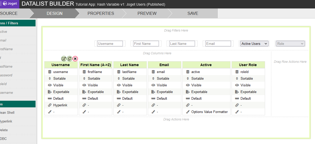

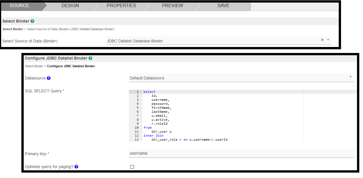

2) I did some initial research this week, but with the Tutorial App: Hash Variable on The Joget Marketplace [link].
What I found was their implementation of the form hash variable only worked by statically loading the WHOLE user database table, into a local datalist via an SQL query.
Then, like your suggestion: it will pull the selection box user/workflow variable from the local datalist:
If your example is NOT doing this, then it could be just what I need. However, if it follows #2 here ... then it seems like extra work (either in SQL queries running to pull the userlist or a duplication of the User Option Binder which already exists).

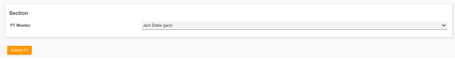

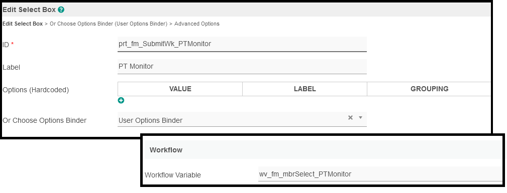

1. Form:
Then if the user wants to send the form to Jack (and Jack gets a reminder), they pick them and hit submit (note: I simplified the form ... it could be like the travel approval example):

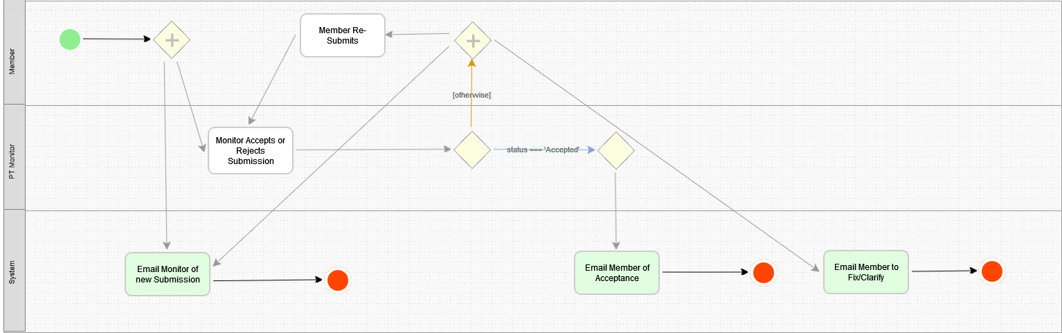

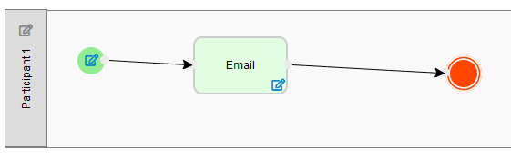

2. Process:

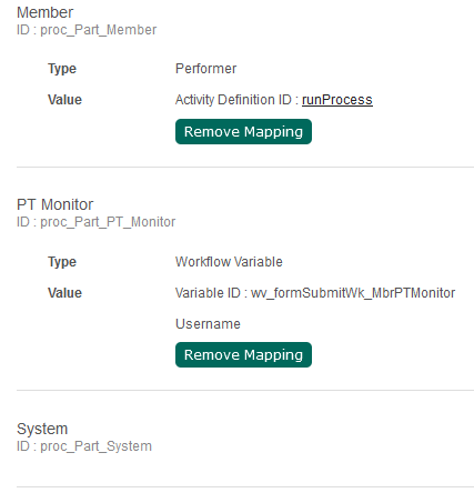

At this point the workflow variable is mapped to the "PT Monitor" Form/Datalist Inbox AND it would send an email. (ignoring the rest of the Process/Workflow example – but again see the Travel Approval Examples). NOTE: The Cycle for the PT Monitor Rejecting and Member "re-submitting works".

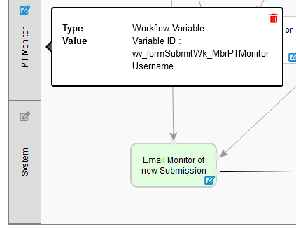

However, I will note that the PT Monitor is mapped as the Workflow Variable... but the System is not:
And:

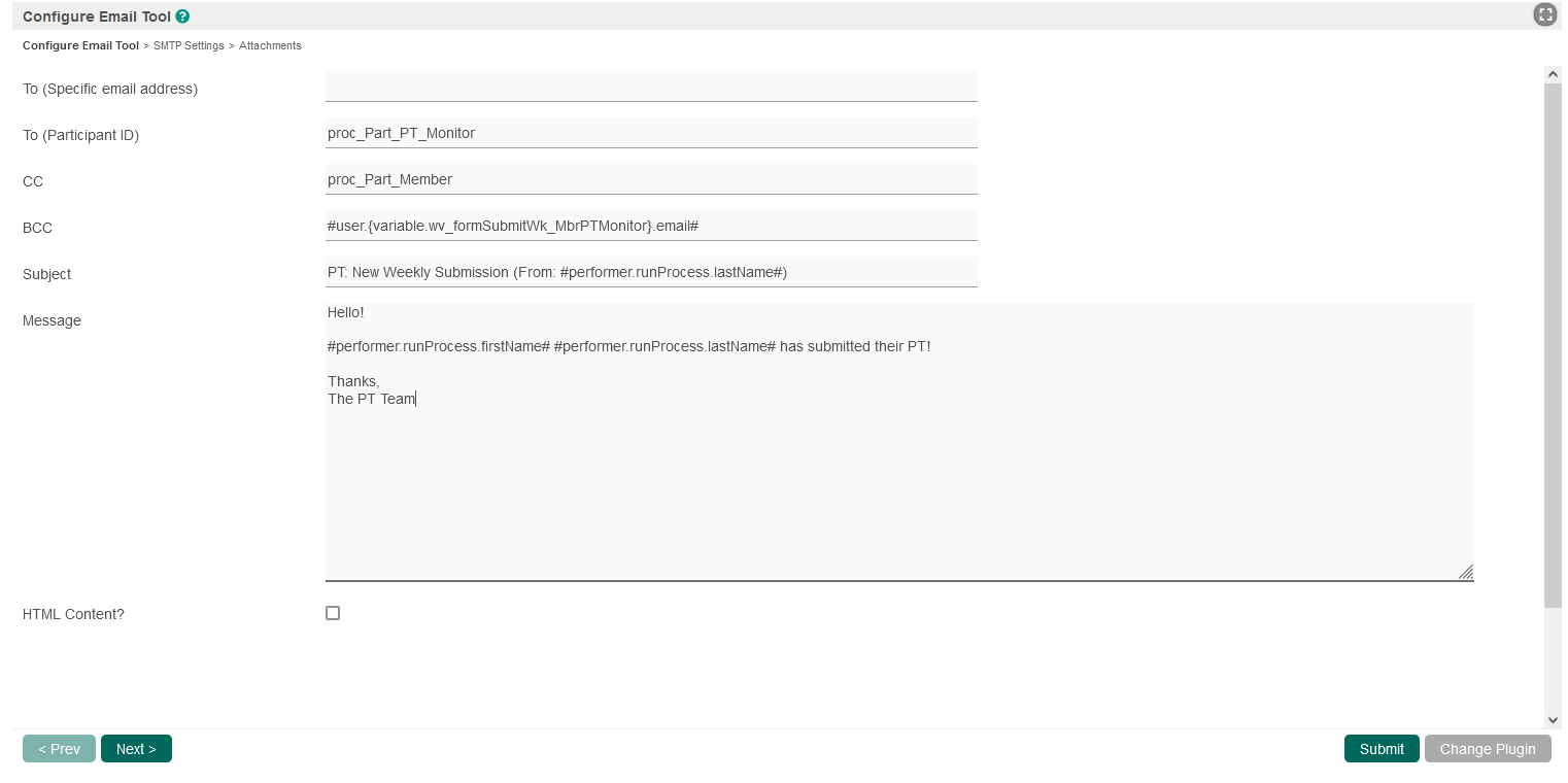

3. Configuring the Email Plugin.
Thus I'm trying to email the PT Monitor, CC the user (aka the Member) ... which stems from selection from the person in the form ---^ :
In this case, I'd expect the user I logged in as to get the CC, and "Jack Drake" to receive the email.
