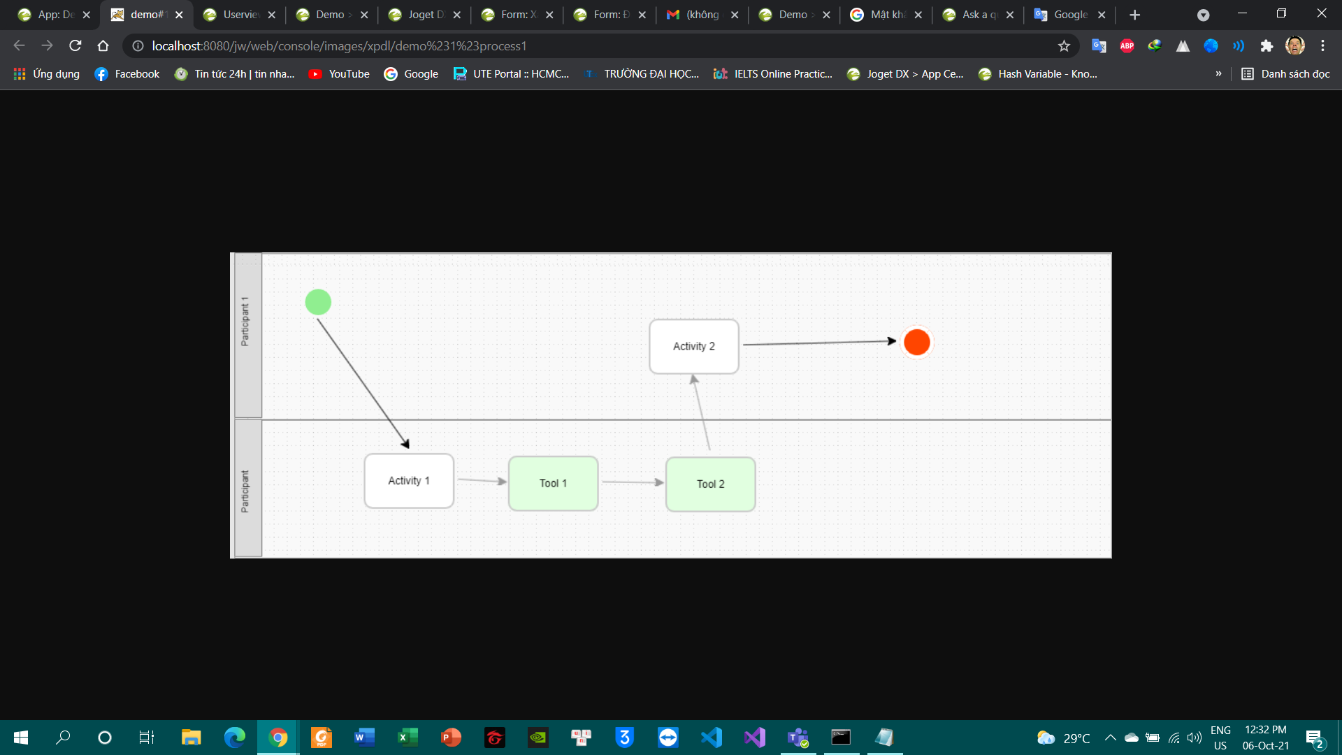

Hello everyone, I have a process like this: Anonymous sends a form to admin. Then admin approves and sends that approval form to anonymous above by Email tool with url as inbox containing approval form.![](/community/download/attachments/177406280/Screenshot%20%283%29.png?version=1&modificationDate=1633498409000&api=v2)
The problem here is that when I use the admin account to access the above url, it goes to the correct approval form I want, but when I am anonymous, I access it and it says "Assignment Unavailable"
Is there any way to help me?
