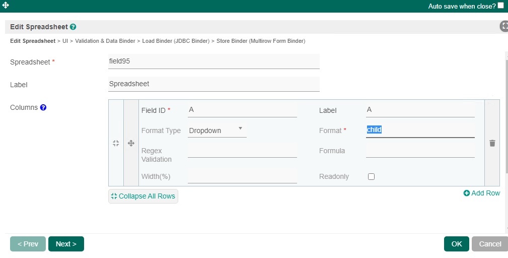

In your spreadsheet column set up, your column name need to be 'A' since your data set is return the columns as such.
In spreadsheet column I did declare the column name and label as A, format type as Dropdown and Format as 'Child'. Im not sure on format, so I follow as guide in JDBC Form Binder..
But once O preview, the value still not in drop down.
I got one query which is call from MSSQL (query set in load binder: JDBC binder).
SELECT TrxRem1 as 'A',TrxRem1 as 'A'
FROM cb.dbo.pp WHERE TNo = 'pp012200040'
How to display this result in spreadsheet drop down?
Had tried follow guide in JDBC Form Binder but, the dropdown not display any value.![(sad)](/community/s/-3l6q9a/9012/cuccqr/_/images/icons/emoticons/sad.svg)
