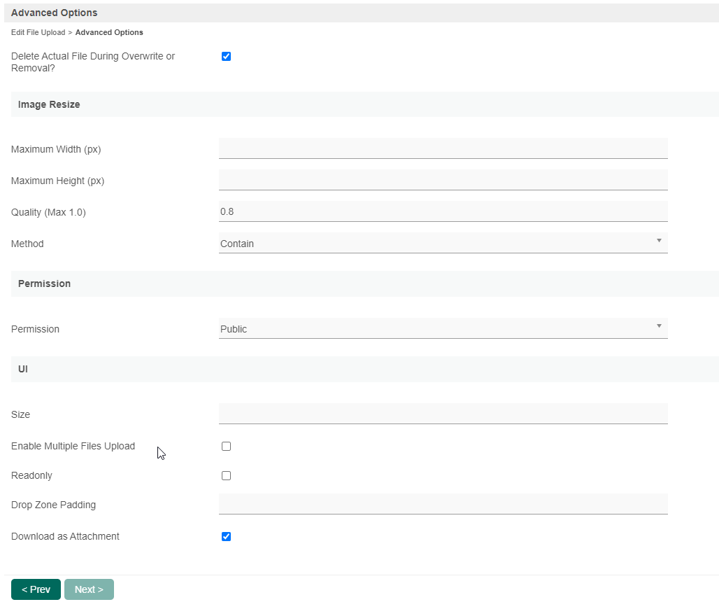

Hi, I suspect that this is caused by the permissions to the file upload. Can you share the permission configuration for the File Upload field?
Hi Anders,
Permissions set to Public, dont know how to make it more open than that:

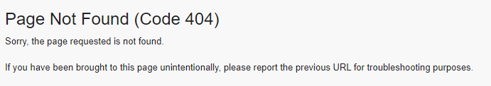

Problem is, that link returns a 404 Page not Found:
This is a simple form, FileUpload Permission is set to Public. Uploaded File Storage Base Path setting left as default. The file is uploaded, I can see it in the folder. The generated link returns 404.
