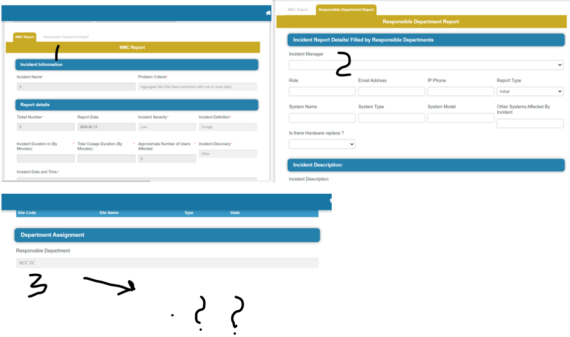

I think this issue can be solved by updating the plugin version the latest section-tabs-7.0.13.jar release.
You should uninstall your current plugin and download and install the latest version from https://marketplace.joget.com/jw/web/userview/mp/mpp/_/vad?id=section_tab_plugin-v1
Do delete and update the latest plugin in all your Joget servers and local PCs.
You may sometimes need to clear your browser cache for the new plugin to take effect.
Hope it helps!
im having an issue with the section tabs plugin, i have 2 sections one is longer than the other and when i click on the second section which is the longer one and then return to the first section a white space shows below the section, why is this happening and what should i do to stop it ??.![](/community/download/attachments/282362685/ace.PNG?version=1&modificationDate=1715087280000&api=v2)
