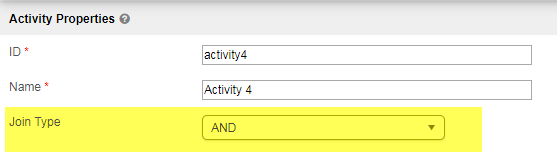

Figured it out. In the example above, we need to set the Join Type to `AND`.
Example:
See similar question: What is the exact difference of the properties "Join Type" XOR ; AND

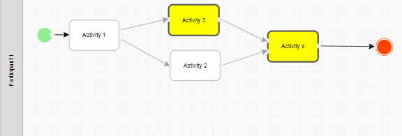

If a process has an Activity that has multiple Input transitions, should Joget wait to trigger that Activity until all of the Inputs have been satisfied?
Example: In this simple process, I would like for both Activity 2 and 3 to be prerequisites for Activity 4. However, as soon as Activity 2 or 3 is complete, Activity 4 is triggered (as you can see in the graph).
![](/community/download/attachments/29821699/2017-11-15_10-18-33.png?version=1&modificationDate=1510759399000&api=v2)
I have a more complex workflow where at times it seems to work as I desire, but not always. Is there a way to enforce this logic?
