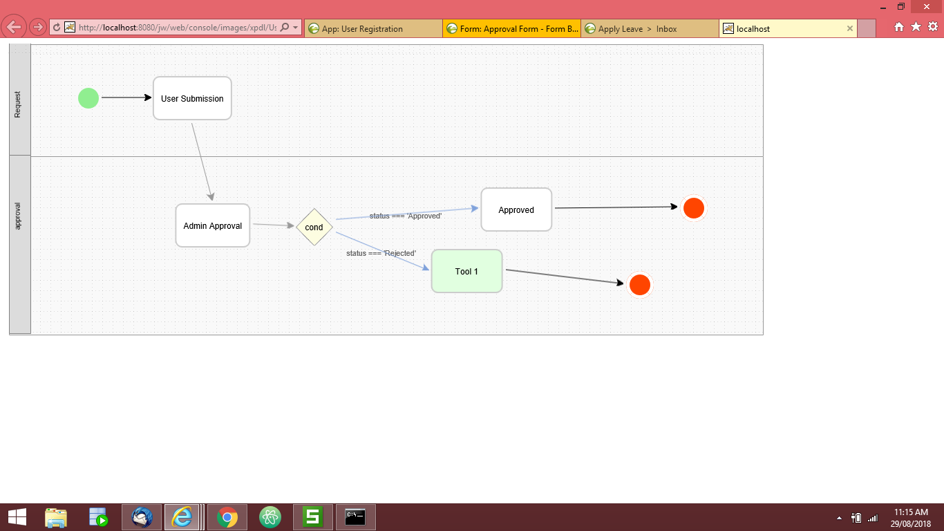

My Idea is: User(say ash) will fill a form in respective login and the admin should get an approval message in admin inbox, when the admin approves the message in his inbox it should be updated and user(ash) should get an message about the completion of task.
I use: Joget v6 Community edition
What i have done is: Admin will fill form and receives an approval message in his inbox and process further by approving or rejecting.
This is the workflow:Workflow.png

      1. ashvitha
        No i want the admin to receive a message when the user submits a form
      2. ashvitha
        AIM: When user ash submits a form, admin should get an approval email in admin inbox(Admin is a different user)
      3. Justin
        By right, Admin would already see the assignment in his Universal Inbox when user Ash submits a form. Do check your participant mapping. Cheers.

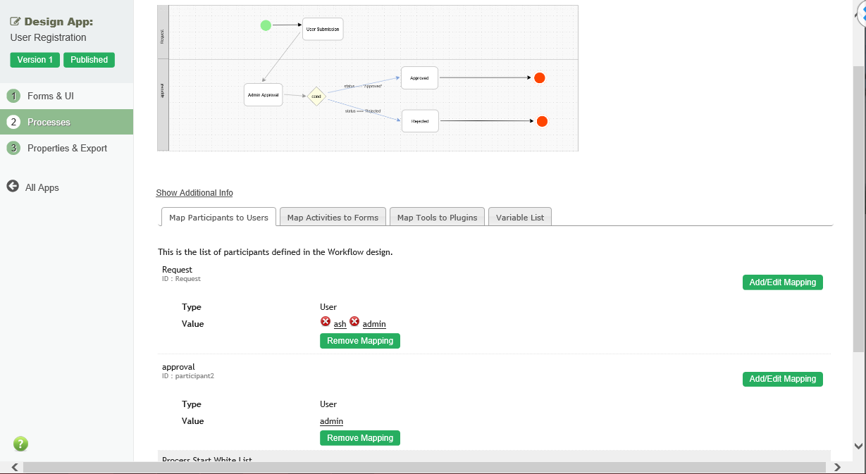

      4. ashvitha
        I have attached my workflow. Plz help me with participant mapping. Thank you Justin
      5. Justin
        Hey ashvitha, I do not see any attachment related to participant mapping. Please attach a screenshot and configuration of the page for "Map participant to user" in your app design. tq.
      6. ashvitha
        This is my workflow(Workflow.png) and user mapping (Participant Mappingpng). Tq in advance
      7. Justin
        Hey there, The participant mappings and workflow seems correct. Try checking if forms are mapped to the correct activities.
