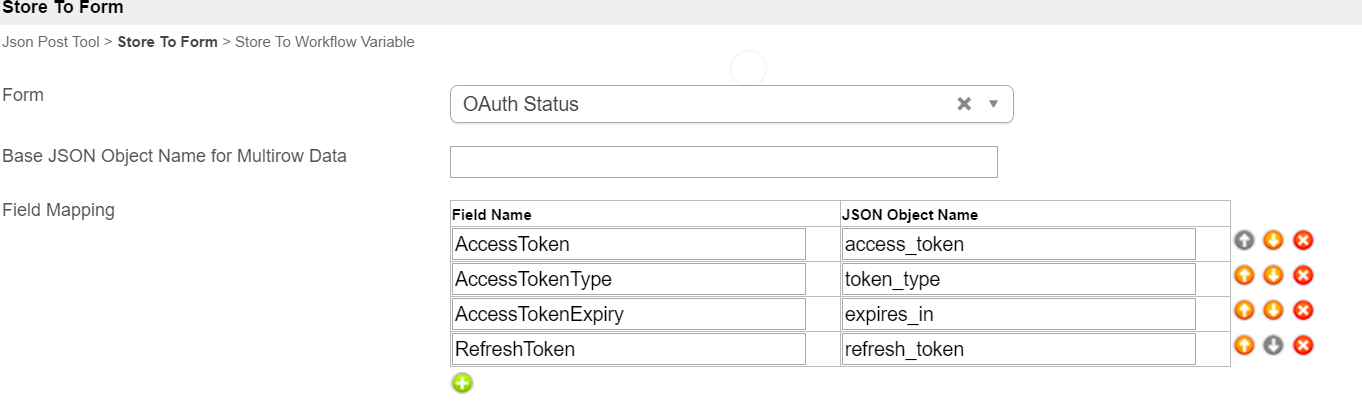

Hi guys,
I am currently on v6 beta and working on something with the JSON POST Plugin.
It looks like the https post request goes out properly and that I get a response from the server.
However, the response fields are not stored and I get this error no matter what:
This is the response from the server when testing the POST request in another tool:
Config:![](/community/download/attachments/26773947/image2017-4-14%2017%3A29%3A31.png?version=1&modificationDate=1492148183000&api=v2)
Any ideas what the problem might be?
