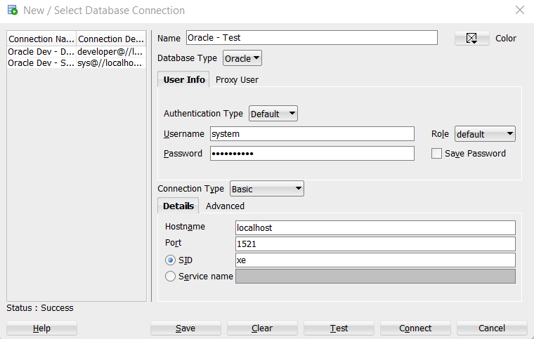

You can also follow this if you want to use docker container . https://medium.com/geekculture/run-oracle-database-21c-in-docker-351049344d0c
and once the database connection is successful,
Ensure that the username and password as in the one that you use for when you configure the database connection.
Example :
hostname: localhost
port: 1521
sid: xe
service name: xe
username: system
password: C##oracle123

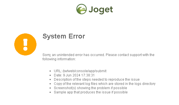

Iam facing issue after connected oracle as data source,
as you can see, it shows when create blank app after switch db from default to oracle.

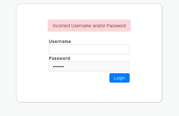

and it showed after I tried restart joget server after connected oracle.
what should I put on this login form? I tried admin/admin as user/password but failed.
please help, any suggestions will help.
