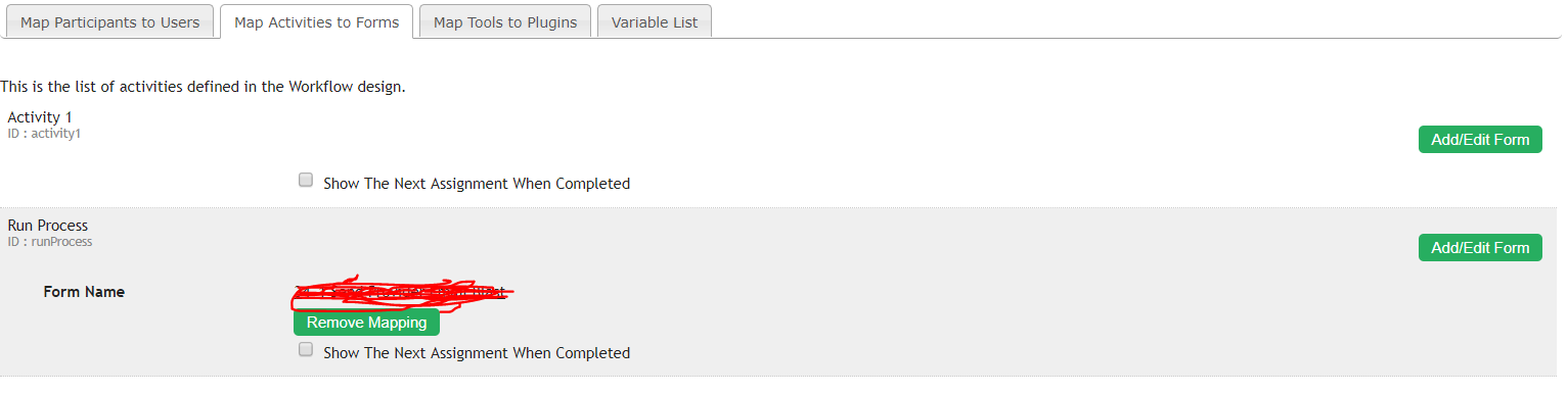

This is a well known problem. you can remove the activity from process where you submit the request and instead you can map the form at "Run Process":
The process will only start when a form is being submitted.

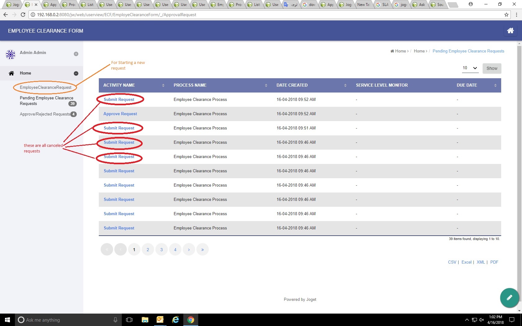

I have a created a simple request submittion application where you can submit a form for approval.
the problem is that each time a press on "New Request", if i dont want to fill the form and just close the window, the form/request still appears in my inbox userview under the Activity name![](/community/download/attachments/30576864/Joget%20Employee%20Clearance%20Form.jpg?version=1&modificationDate=1523873039000&api=v2)
