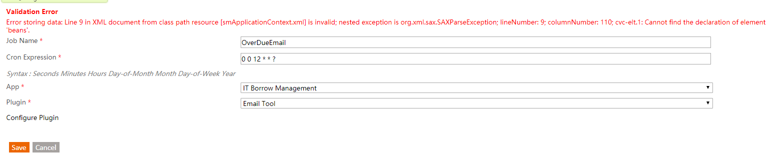

When I use the Scheduler plugin(v6.0.0)from market place. the system has show the error:
Error storing data: Line 9 in XML document from class path resource [smApplicationContext.xml] is invalid; nested exception is org.xml.sax.SAXParseException; lineNumber: 9; columnNumber: 110; cvc-elt.1: Cannot find the declaration of element 'beans'.

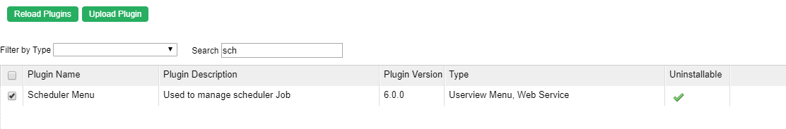

I have remove and reupload the new version plugin from https://marketplace.joget.com/jw/web/userview/mp/mpp/_/vad?id=scheduler_v6-1
But it still show me the error when I click save.![](/community/download/attachments/33096609/SchedulerError1.png?version=1&modificationDate=1544854781000&api=v2)
![](/community/download/attachments/33096609/SchedulerVersion.png?version=1&modificationDate=1544854781000&api=v2)
Please tell me what's the wrong with my action? how to use the plagin?
