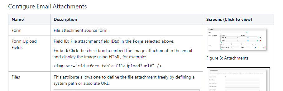

Hi
I am using Joget DX 7 Enterprise 7.0.9
I am trying to use the Email Tool to send an email that includes a form as attachment but it does not seem to work.
I can send an email with a File attachment but not a form.
I am following the instructions below but the description is not clear to me.
