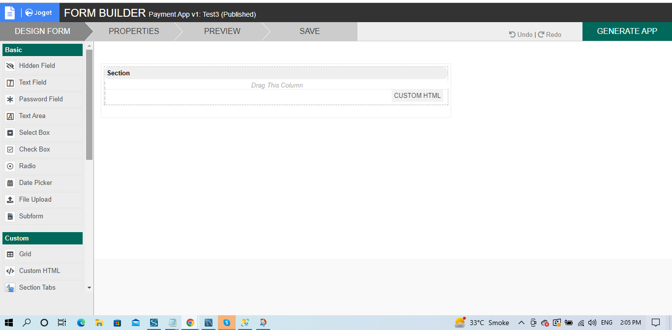

Hi, if you are not able to load the form, perhaps you could try fixing the definition directly in the database. Locate your form definition in the database table "app_form", and correct the error in the "json" column.
Loged in as admin user.

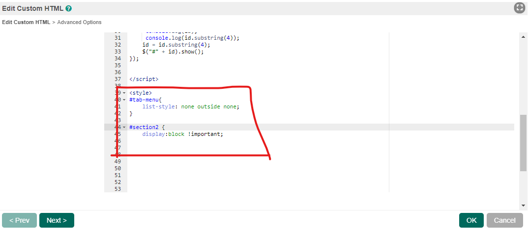

I have created a form for my company and added some css in custom html. i have not just added the curly bracket for my css And now the bottom pencil icon is not visible and save button is not working.
i have removed the all css from custom html but now also the bottom pencil icon is not visible. Tried refershing page many time. Unable to add changes to my form.
after adding this css with missing curly brackets
bottom pencil icon is not visible .Preview and Save button is also not working.
