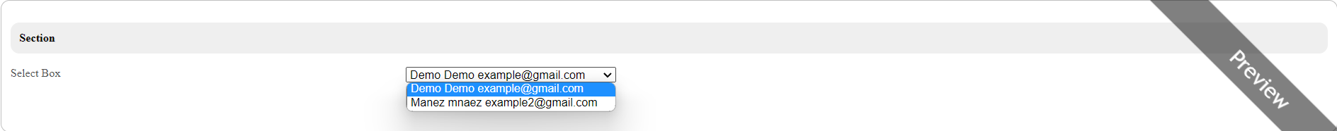

Output Preview:
See Bean Shell Programming Guide#Usages for more information. Thank you

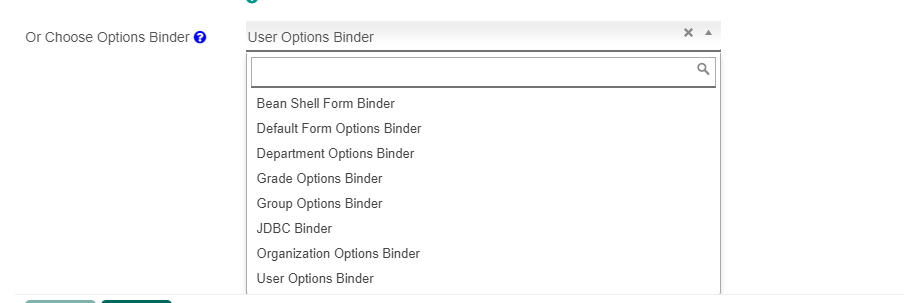

I want User email From The External directory
![](/community/download/attachments/229901940/image2023-1-12_12-22-34.png?version=1&modificationDate=1673506381000&api=v2)
I only Get user name and full name
is There any option to get user email from the external directory
