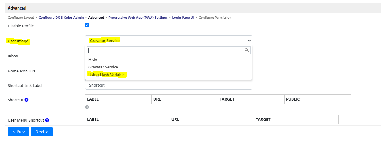

Go into App Userview settings and then find User Image property. Configure it as shown in the pic below and then use hashvariable which points to the pic stored against the logged in user
