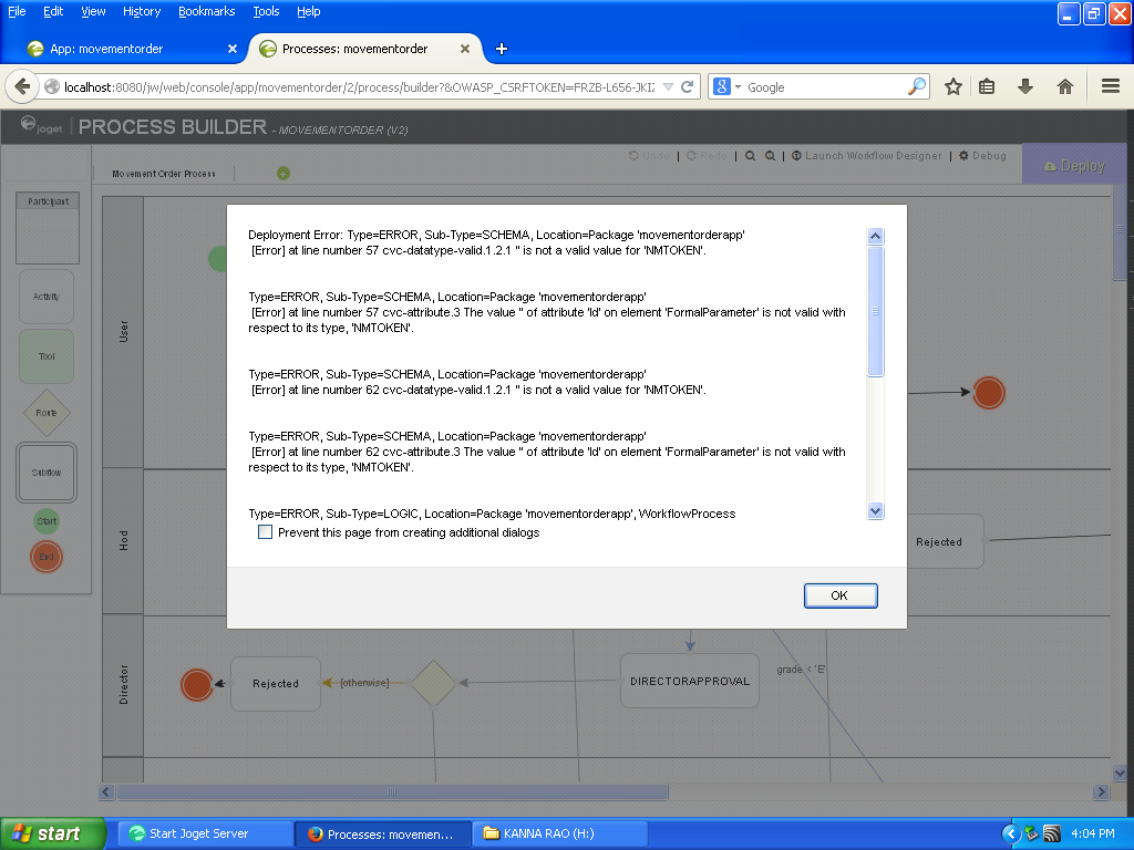

[Error] at line number 57 cvc-attribute.3 The value '' of attribute 'Id' on element 'FormalParameter' is not valid with respect to its type, 'NMTOKEN'.
[Error] at line number 62 cvc-attribute.3 The value '' of attribute 'Id' on element 'FormalParameter' is not valid with respect to its type, 'NMTOKEN'.
Type=ERROR, Sub-Type=LOGIC, Location=Package 'movementorderapp', WorkflowProcess 'movementorderprocess', FormalParameter '' -> Id
Invalid Id
Non unique Id
Invalid Id
this is the error i am getting while deploying process
Deployment Error: Type=ERROR, Sub-Type=SCHEMA, Location=Package 'movementorderapp'
[Error] at line number 57 cvc-datatype-valid.1.2.1 '' is not a valid value for 'NMTOKEN'.
[Error] at line number 62 cvc-datatype-valid.1.2.1 '' is not a valid value for 'NMTOKEN'.
Invalid Id
Non unique Id
Invalid Id
Non unique Id

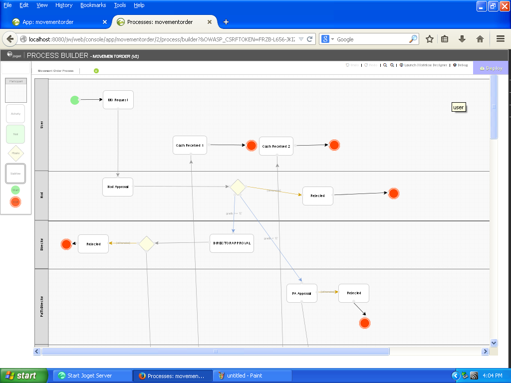

.xpdl file pls remove the error and deploy![](/community/download/attachments/26116554/untitled.bmp?version=1&modificationDate=1482922777000&api=v2)
![](/community/download/attachments/26116554/untitled2.bmp?version=1&modificationDate=1482922777000&api=v2)
.XPDL FILE PLEASE DEPLOY THIS FILE

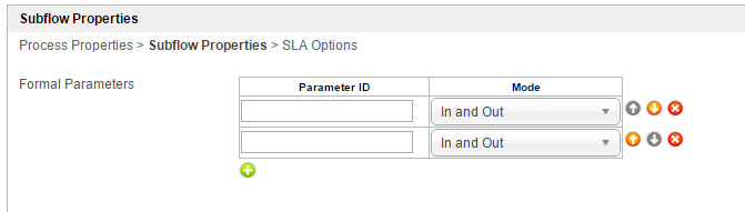

<xpdl:FormalParameters>
<xpdl:FormalParameter Id="" Mode="INOUT">
<xpdl:DataType>
<xpdl:BasicType Type="STRING"/>
</xpdl:DataType>
</xpdl:FormalParameter>
<xpdl:DataType>
</xpdl:DataType>
</xpdl:FormalParameters>
