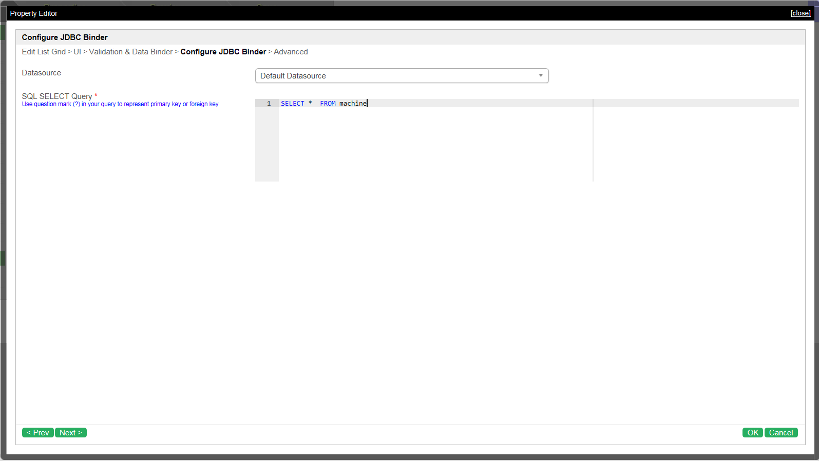

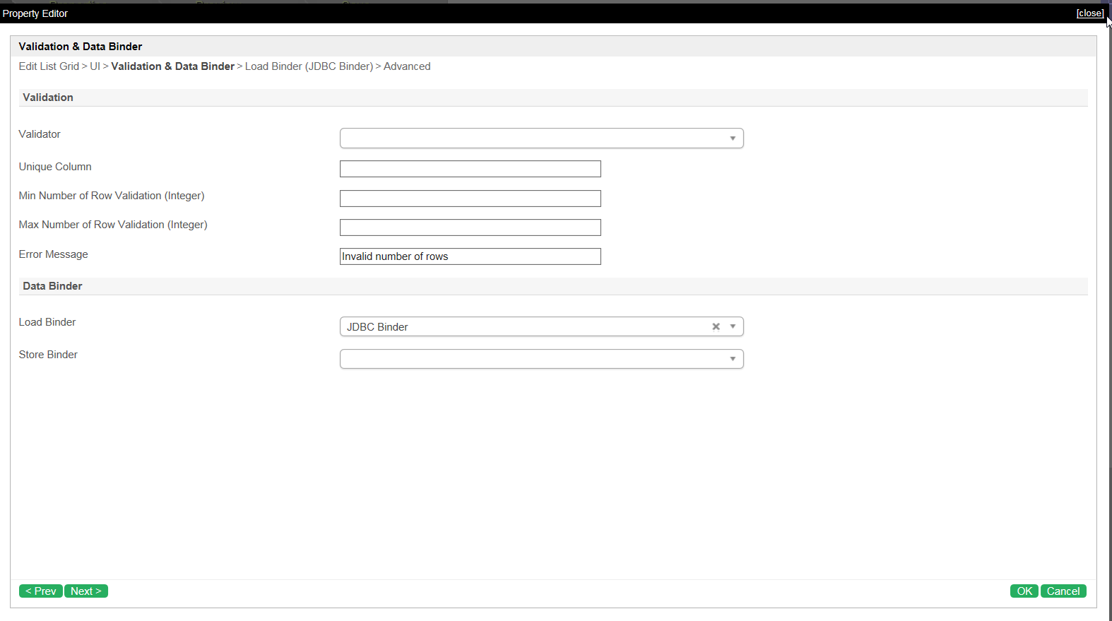

I have read all the documentation and also check how the list grid was set. So what I did is to fill the "load Binder"with JDBC BINDER then did a select. It still not working and I really don't understand why... Thank you.

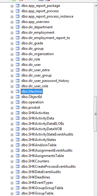

Database tables are usually case sensitive. Best you type as follows: "select * from Machine"

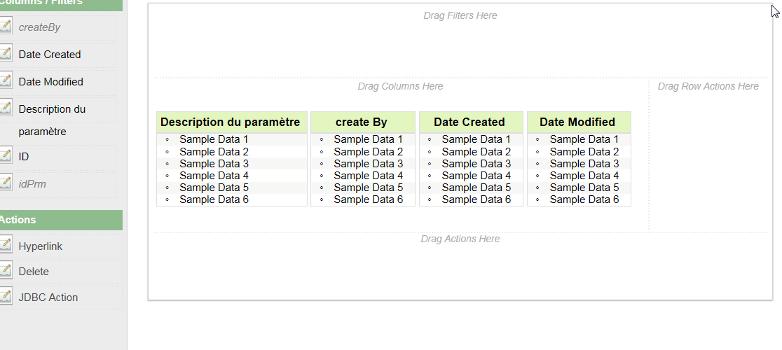

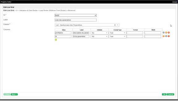

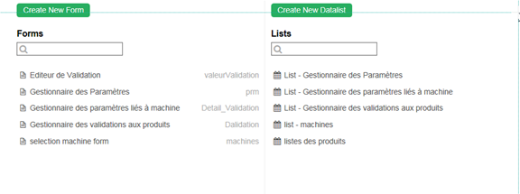

first I decide to try filling the list with a other list " list - Gestsionnaire de paramètres". This list is link to a form called " Gestionnaire des paramètres" ( see new picture in responds).
Now, what I am trying to do is to fill the list grid in the form "Gestionnaire des paramètres liées à machine" with all the data of " Gestionnaire des Paramètres" ( see new picture).
My question is: 1)
Do i need to put every columns of the list in the list grid ? ( see two pictures)

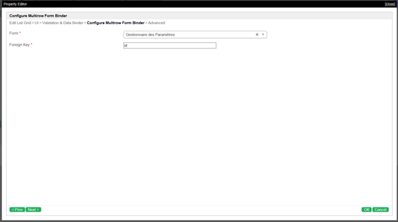

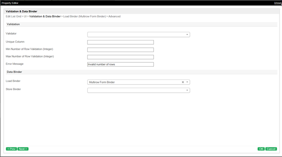

2) I am trying to load the list grid like you said with multirow Form binder which I setup. ( see picture) I tried to do as you say with a parent form, but I don't understand verywell the configuration of it. How am I suppose to say this form will be the child of this other form...

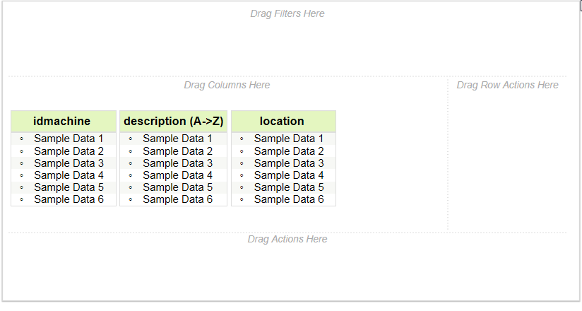

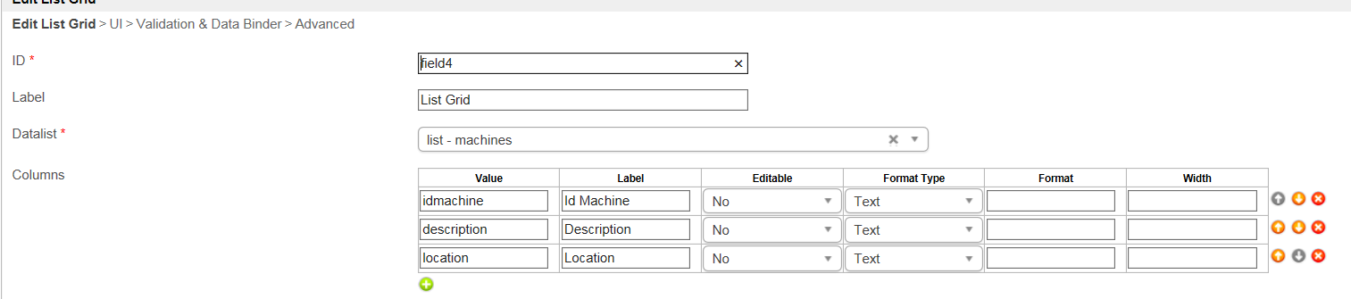

Configured list in the form.
The Value are the same as the label.

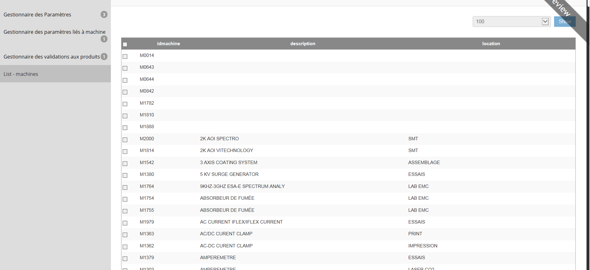

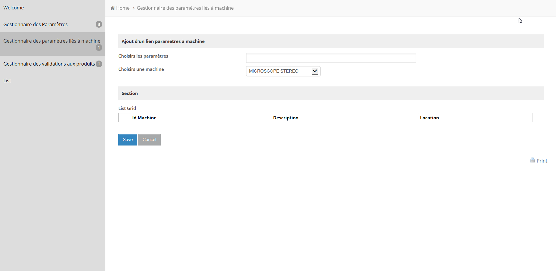

Here's the list in the userview:
Here's the list in the form:
Here's what I have modify:
and like I said, my table name is "machine":

Here's my the form and list I use:

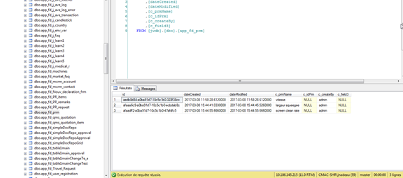

here's the date of the form "Gestionnaire des paramètres :
Here's how I set up my list grid to be fill:![](/community/download/attachments/26773072/image2017-3-16%2012%3A9%3A59.png?version=1&modificationDate=1489680689000&api=v2)
here's my list of "Gestionnaire des paramètres" :
