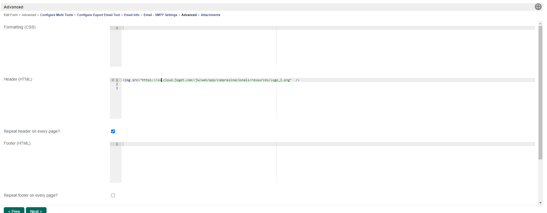

Actually the image you provided is shown on pdf but my image does not, even if I paste the url on browser the image is shown, so the url is correct. Probably localhost on img tag might have issues.
Matthew King Thank you for this great input, but i'm using this as a extract form to pdf and sent it to email.
When i receive the pdf on the email, my image stay bellow the form.
I use only this code in the Export Email Tool. How can put this correctly?
Best regards
