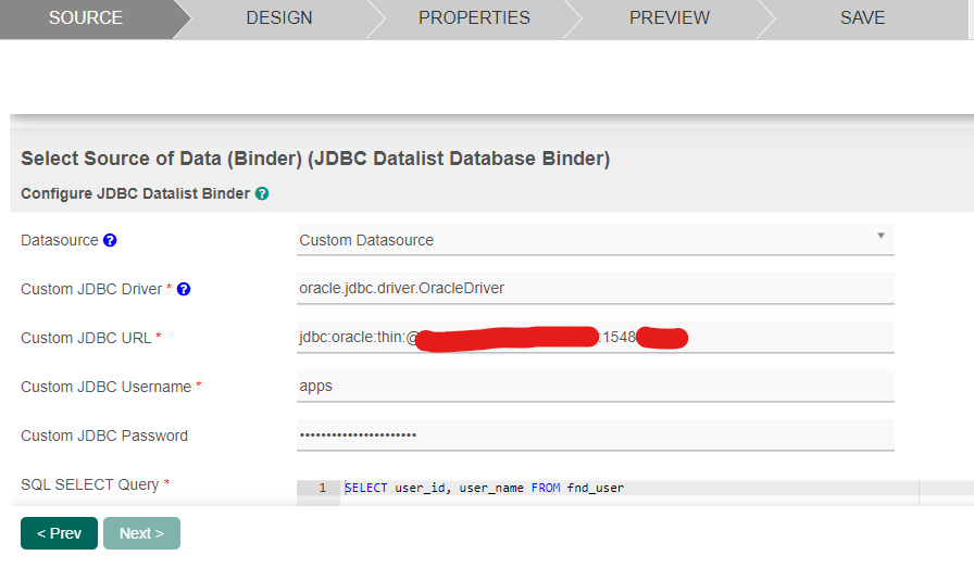

Source of Datalist
Do check the joget.log for explanation errors from the datalist JDBC binder.
I have solved the problem by copying file orai18n-12.1.0.2.0.jar into folder <Joget Directory>\apache-tomcat-8.5.77\webapps\jw\WEB-INF\lib as per joget.log advised.

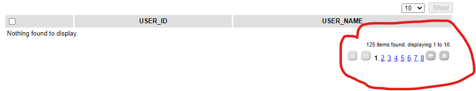

Help me please,
I use Datalist by reading the data from Oracle database. It show number of item but not show the data as image below.
