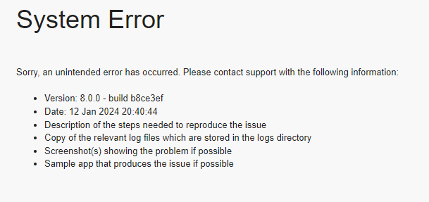

I am having this same problem. I have updated everything to the latest version and I still can't download the report.
Hi, I notice that you are using a much older 8.0.0 version. Try updating to the latest Joget version, along with the latest Report Builder version too.

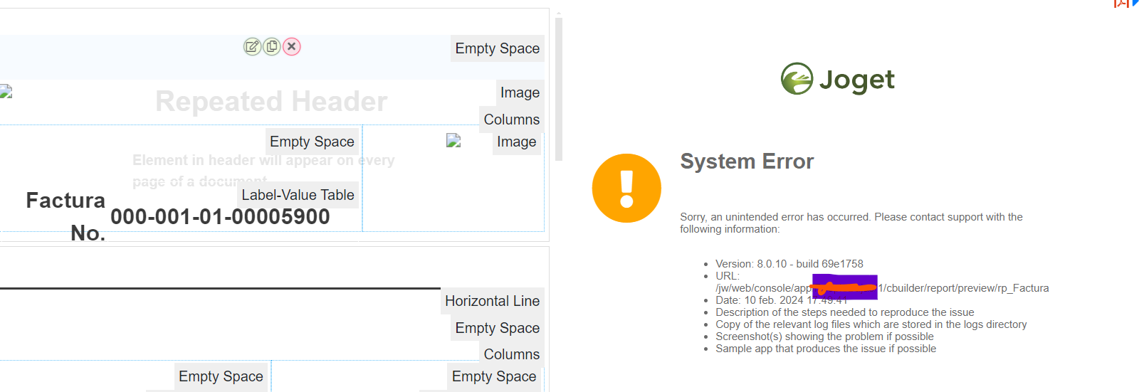

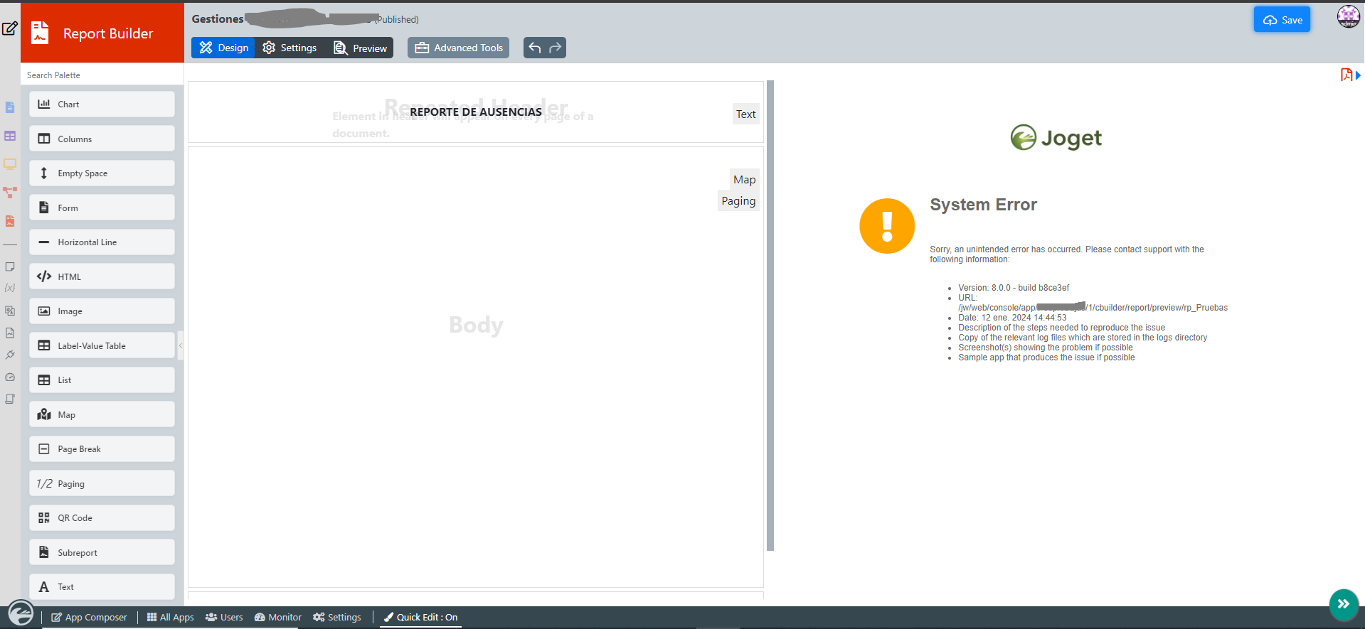

I recently updated Joget to its latest version. However, I encountered an issue when trying to add images to the reports. When I attempt to download the report, I receive an error message stating that the file cannot be opened. Additionally, in the report preview, I only see a similar error message.

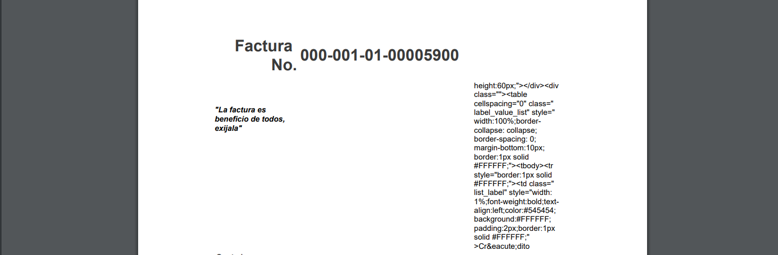

If I remove the images from the report, I can view and download it without any issues. However, in doing so, the downloaded report displays HTML that seems to contain the styles of the added elements.

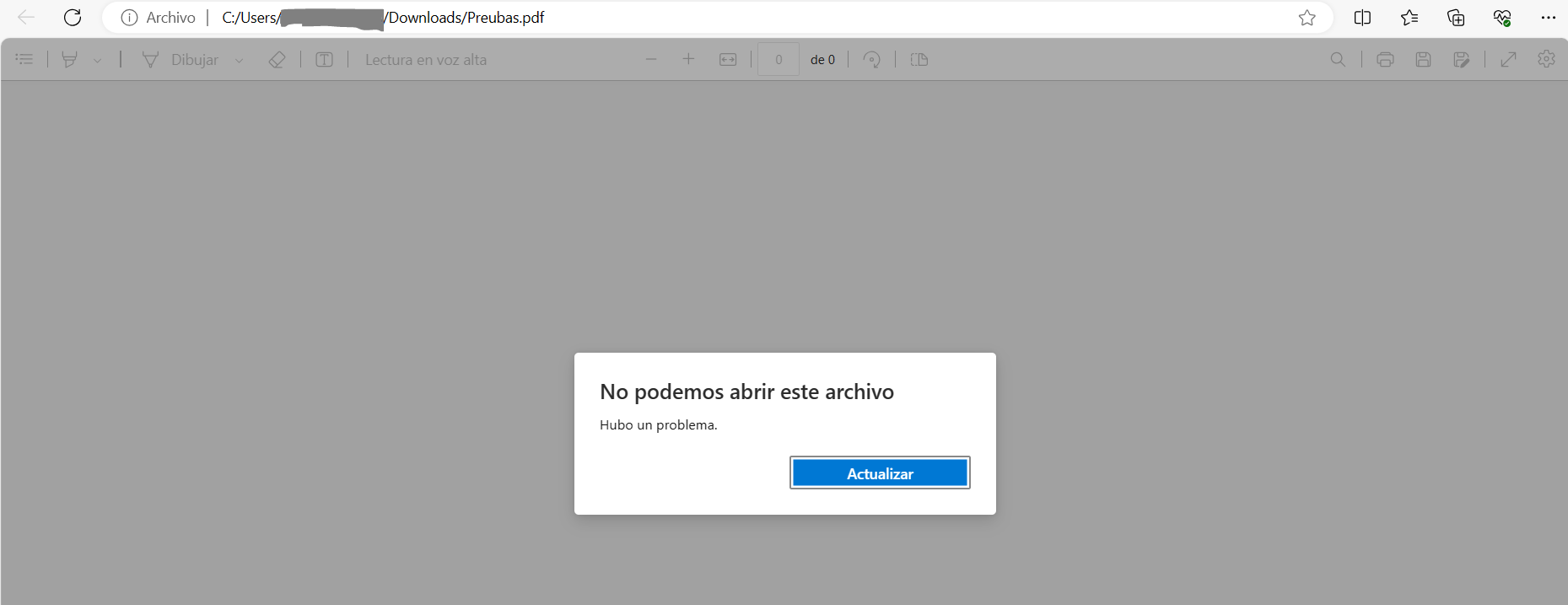

I'm facing issues when trying to download a list in formats other than CSV and XML. When attempting to download in PDF and Excel, a specific error occurs.
Additionally, when trying to download a PDF report using the Report Builder add-on, although the file is downloaded, I'm unable to open it successfully. Could you assist me in resolving these issues?
