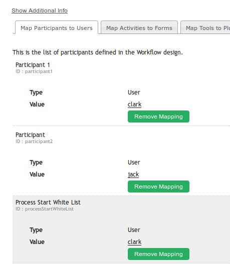

example, Purchase Requisition Process says the "Requestor" is mapped to Performer in the org chart. Since I don't know where it's described, I've mapped it to user "cat"... but when I try to do a "New purchase requisition", the page says "Is there a book or a doc somehere I shall understand how it was built ?
Hi Stef Are you running the Joget Enterprise Workflow? Cos the Leave and Purchase Requisition apps are designed for Joget Enterprise version only. Joget Enterprise Workflow platform is free for 3 users. For question 2, go to Run Process and click the button "Remove Mapping" below the heading "Process Start White List ID" to allow any one to run the process, even if you are not logged in.

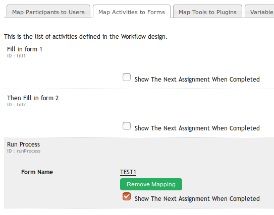

The starting point of this workflow is the RunProcess or you can set it to the first activity in your workflow (for this, leave the RunProcess mapping empty).

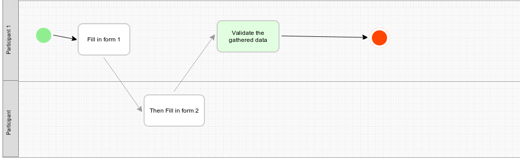

I'm new to Joget and i would like to implement a process like this :
I've setup 2 forms and this process :
Where's the starting point of this workflow ?
If I log in with clark, nothing happens when I fill the form 1![(sad)](/community/s/8kxef7/9012/cuccqr/_/images/icons/emoticons/sad.svg)
