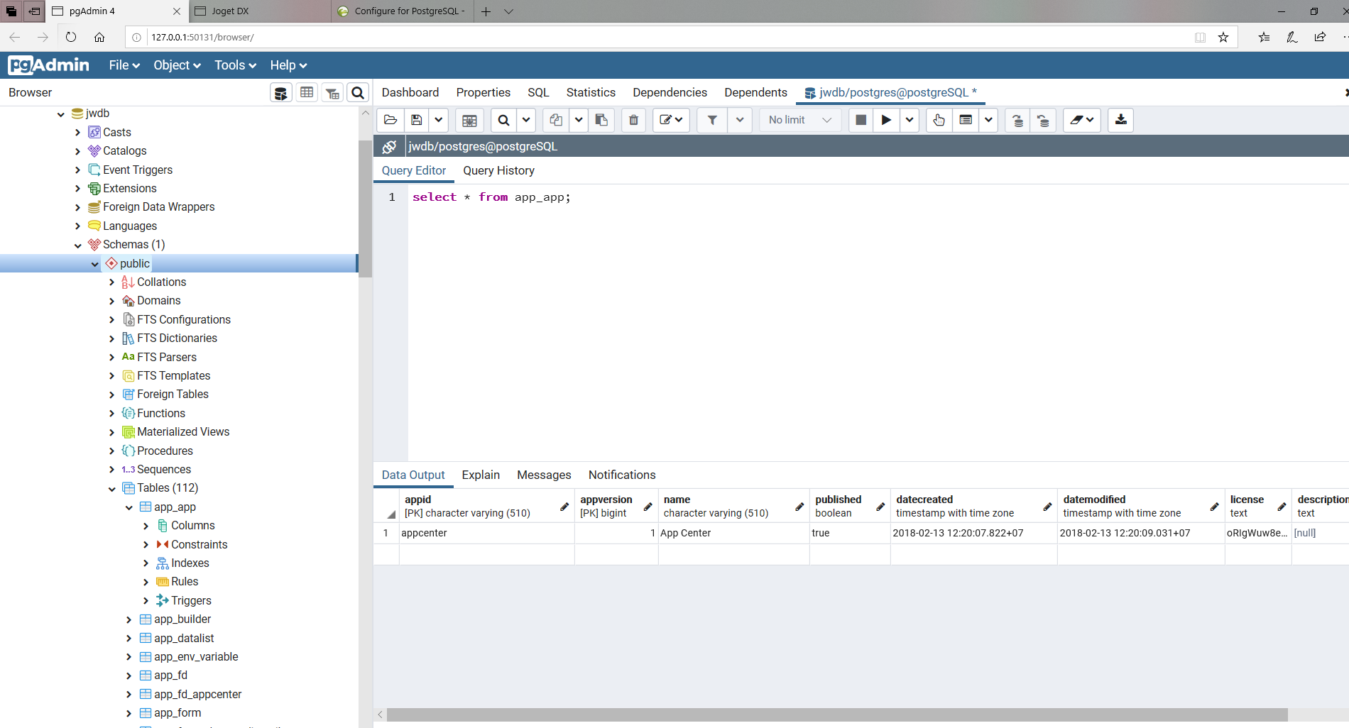

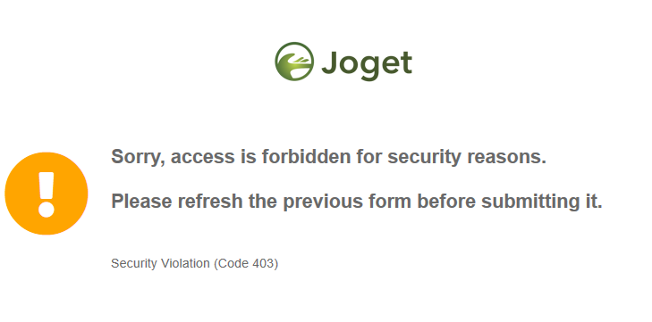

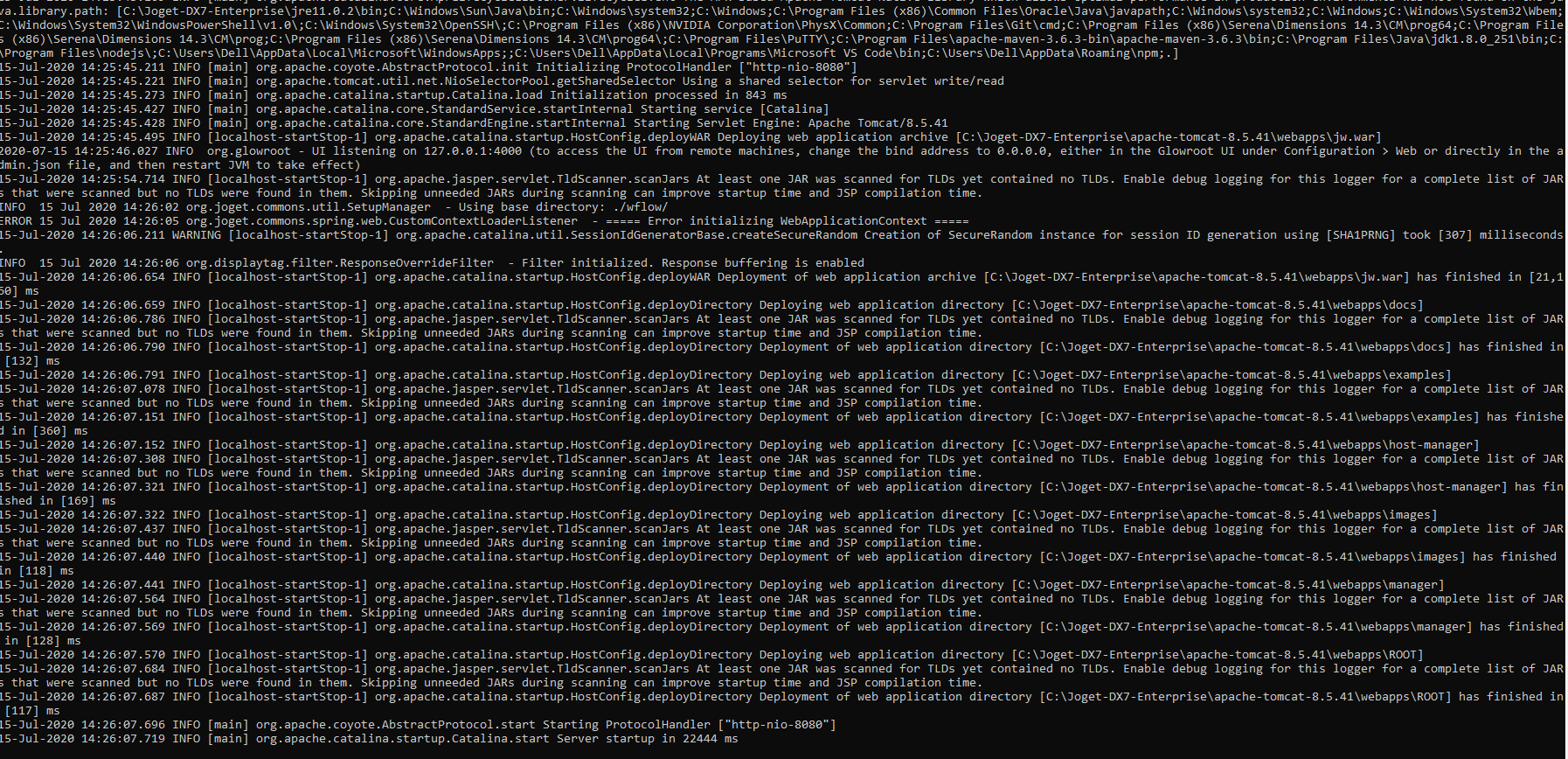

I don't have any username for may PostgreSQL and configuration except workflow user is that true ?
please help
my configuration, I follow all step to connect Configure for PostgreSQL
currentProfile=postgresql

workflowUser=
workflowPassword=p@ssw0rd
workflowDriver=org.postgresql.Driver
workflowUrl=jdbc:postgresql://localhost:5432/jwdb
