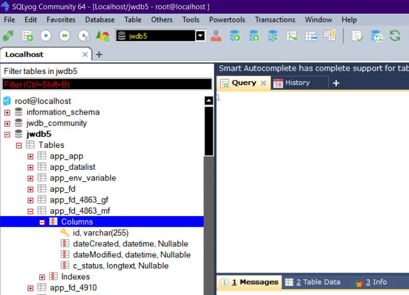

If you are running Joget Workflow on MySQL, you can download and install this free Windows database management tool SQLyog Community to view the database, tables and columns generated by the Joget forms. See image below.
If you define the table name in the Joget form as "yourtablename", the full table name in database is app_fd_yourtablename.
If you define the field name in the Joget form as "firstName", the full column name in database is c_firstName. Exception is the primary key remains as "id".
thank you Andrew!
I want to use jdbc binder, but i don't know the name of column name setup in joget database to make the query. for example the organization column name and group name assigned in database. how i want to solve this?
can i view the database?
